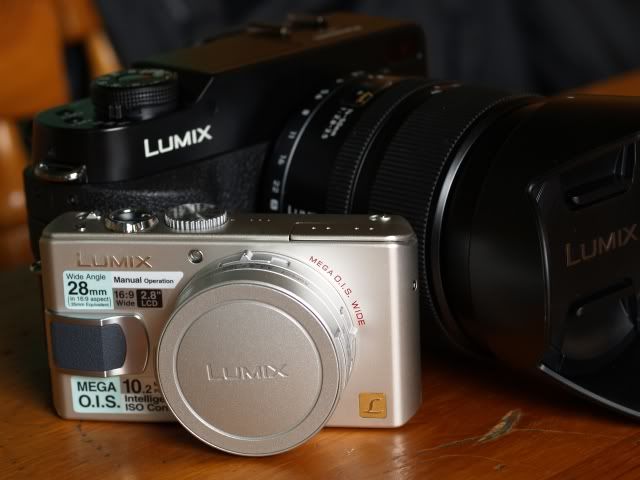

The f-stop of a lens is calculated by dividing the focal length by the aperture value (the width of the opening), one very important aspect of f-stops is that they are the same when referring to different lenses - this picture is a good example:
This shows the Panasonic LX2 against its L1 sibling, clearly the LX2 is tiny in comparison to the much larger SLR. Despite this, both cameras have the same effective focal length of 28-100mm and both have a maximum aperture of F2.8 at 28mm despite the fact the SLR lens is far bigger than LX2. When shooting the same scene both cameras will produce the same shutter speed at 28mm F2.8 although the depth of field will be different.

Back to the picture above with the Panasonic LX2 and L1, as mentioned both cameras have a similar equivalent focal length - the L1 lens has a 28-100mm range and the LX2 is slightly longer at 28-112mm. The actual focal length can be found by looking at the lens itself, the LX2 lens is 6.3-25.2mm and the L1 is 14-50mm. Conceptually it's easier to use the L1/14-50mm lens to explain where this equivalent focal length comes from, the 4/3 sensor in the L1 is almost exactly half the diagonal size of a 35mm sensor. If you imagine the L1 has a 10MP sensor and a 35mm camera also has a 10MP sensor it means that the 35mm camera (ignoring the slightly different aspect ratios) will produce a similar 10MP image with a 28mm lens. Alternatively if the 35mm camera has a 14mm lens mounted, cropping out a 4/3 sized section from the middle would produce the same field of view as the L1 with its 14mm lens however the resolution in this case would be lower.
